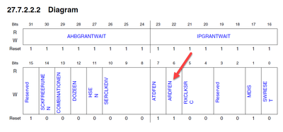

1) is not only a typo - there is no such flag in any of the MCR registers providing this kind of functionality
Knowing about the FIFO behaviour is essential for me, as I'm doing a low level abstraction in C++, and need to know how to operate it. Unfortunately, this is not clear from the reference manual.
What I found out: the FIFO seems to rotate its content by watermark steps each time, the watermark flag is cleared by W1C. Therefore, the correct way to push/pop data to/from it, is to do that from DR[0] by chunks of watermark size.
Just a few sentences of explanation in the manual would have saved me and my colleagues several hours of poking around in the mist. I love this platform, however I need to say: the documentation - despite its quantity of 3500 pages - the documentation is quite disappointing in quality.

1) In my previous reply, I forgot to upload a figure which shows the MCR0 register and I'll report the error to the document team.

Now, however, I'm struggling with the IP RX/TX-FIFOs, and - no offence! - the i.MXRT1060 reference manual, which not only stands out by misleading wording (eg. the term "sequence number" instead of a much clearer "number of sequences"; at least "xxx number" used in a consistent way over the document), but seems to be incorrect and incomplete in many ways, e.g.
- 27.5.9.1: "If MCR0[ARDFEN] is set to 0x1," - there is no bit ARDFEN in register MCR0!

1) - 27.5.9.1: "If MCR0[ARDFEN] is set to 0x1," - there is no bit ARDFEN in register MCR0!
-- There's a typo in the RM of the RT1060.
