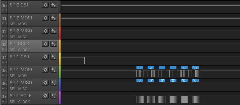

Hello everyone,
Recently I’ve stumbled upon a weird situation when SPIDEV writes to a wrong SPI device and I would really appreciate if someone could point me why that happens.
I have a custom I.MX6Q board with SPI1 and SPI2 on a header. I use kernel 3.10 and have these SPIs enabled in the device tree with two chip selects each.
So I have 4 /dev/spidev records:
/dev/spidev32765.0  /dev/spidev32765.1  /dev/spidev32766.0  /dev/spidev32766.1
echo "hello" >> /dev/spidev32766.0
echo "hello" >> /dev/spidev32766.1
echo "hello" >> /dev/spidev32765.0
echo "hello" >> /dev/spidev32765.1

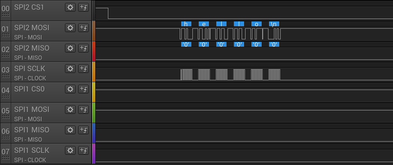

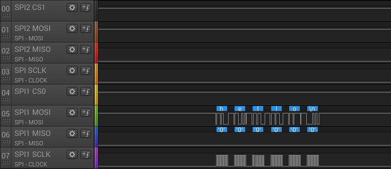

/dev/spidev32766.0 and /dev/spidev32766.1 seem to work correctly with SPI1.
The weird thing - why does write to /dev/spidev32765.0 results in transaction on SPI1 and write to /dev/spidev32765.1 results in transaction on SPI2?
They both should be on SPI2…

Hello Clx,
It is very interesting your case is there any other SPI devices that maybe affecting the  SPI bus? or  any other load that maybe affecting,  I do not see any problem with the definition made by the Device Tree, analizing the case since you are mention that at least it works one of the two SPI dev that it is assign to the SPI2 then it is not configuration, it is like something it is taking control.

clx
There's only m25p80 connected to CSPI1_SS1, but it should not affect the SPI2 bus anyway.
I guess that's a bug somewhere in SPIDEV. Should probably try another kernel version.
