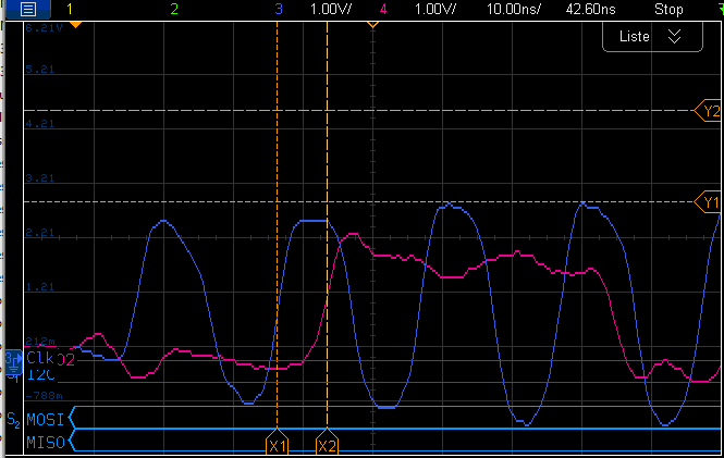

Hey,
I am using ecspi on the cortex M4 core of the imx7. I need to make the communication faster.
At the moment the spi sends a burst of 4bytes. Between every burst I have a break of 2.5µs. Is there an opinion to make this faster? Or any other option to speed up the communication?
The software is based on the freertos example ecspi_polling_master.
best regards
Michael

Hey CarlosCasillas,
I had a closer look on my problem. It seems, the time between the bursts, wont getting shorter, so I increased my clock rate and got new problems.
With the 48MHz CLK, the controller misses the first bit of the frame. I disabled the hysteresis, but the problem still occurs. 2019-12-05 08_25_03-scope_9.png - IrfanView.png
The data is be captured on the falling edge, so I should receive 0b0110xxxx, but I am receiving 0b00110xxx. Physically the correct data is transmitted, but not written into my receive buffer.
