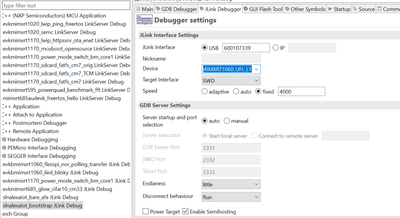

I have 2 questions today. In both cases I am using a J-Link Edu Mini programmer
1) I made a custom board using the MIMXRT1062CVL5A processor. I am having difficulties in programing the device using  my programmer. I keep on getting the error that TD0 stays high. Any Ideas of what to check on my custom board.

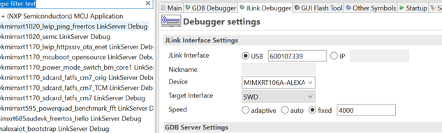

2) I have a SLN-ALEXA-IOT development kit. I have downloaded the SDK and get the list of projects as per document: SLN-ALEXA-IOT-DG.pdf.
I can compile the projects using MCUXpresso V11.7.1 with no errors. I just cannot seem to be able to debug something like "Blinky" or "Hello World". MCUXpresso seems to recognise my debugger and it looks like it is loading something, but it does not debug.
Below is a screenshot of the debugger after programming "Blinky"

First of all, SLN-ALEXA-IOT is not recommended for new design. It is said that Amazon will not support new project.
1. You can try RT-UFL as the download algorithm. Jlink doesn't use the algorithm assign by MCUXpresso. You should copy all files in RT-UFL-1.0\algo\SEGGER\JLink_Vxxx to segger install directory. When you download, type in MIMXRT1060_UFL_L1 for hyperflash or MIMXRT1060_UFL_L0 for qspi flash.
https://github.com/JayHeng/RT-UFL
2. Have you modified slnalexaiot_flexspi_nor_config.c to hyperflash? RT106A and RT1062 are almost same. But you should know that ALEXA demo can't run on RT1062. There is some protection.

Hi @seandutoit ,
I use MCU-Link which is similar to ulink. It works fine. But before debugging led_blinky, you should make a mass erase because there is some encryption related data in flash. You must erase them, otherwise the BootROM will not jump to your code.
I have a jlink-pro. It can download with MIMXRT106A-ALEXA algorithm. But it can't debug. I think it may need a script to set PC and SP pointer.
