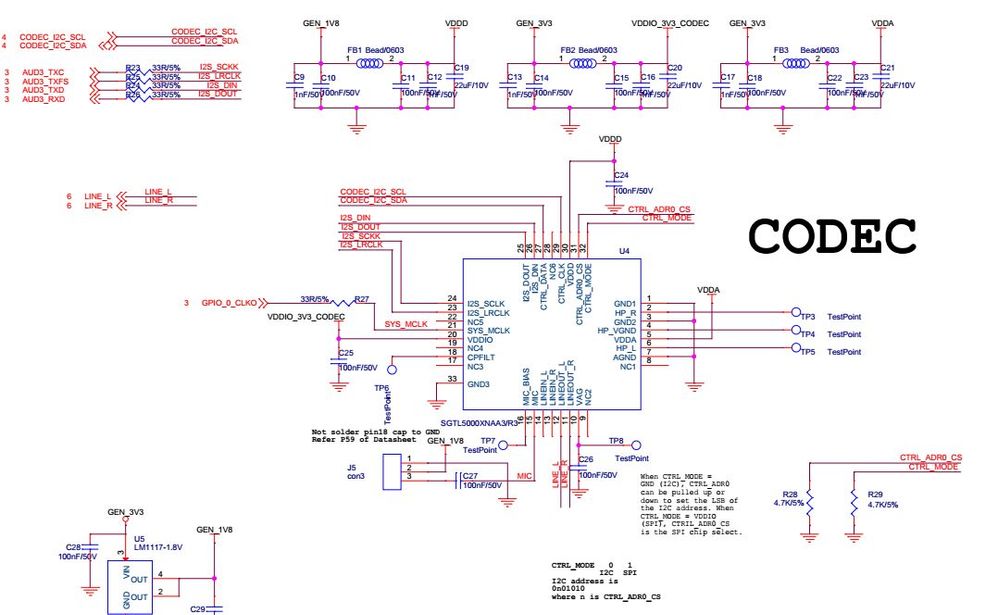

I have a imx6q custom board with using sgtl5000 for sound card ,I configed the devicetree and build the kernel 3.14.52,when I use command "aplay xxx.wav",I cound not hear any sound ,can any one give any advice ?

igorpadykov
Hi jingyang
what bsp used in the case, please check BD bsps where sgtl5000 is well supported
Audio output selection under Linux on i.MX6 - Boundary Devices
please check with oscillosope clock signals, in particular MCLK.
igor

jingyangxie
Contributor V
Hi,I have check the board,the MCLK is 24MHz,I don't sure the sch is right .can you help me check it? sch.jpg

jingyangxie
Contributor V
Hi,igorpadkov
   the bsp is 3.14.52,and the schematic is below:
