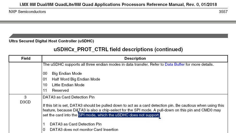

Is SPI bus mode supported in SDIO host controller for data transfer in iMx8 processors? We're currently in stage of board design and we need separate pins for input/output for SDIO. As far as I could understand only SPI transfer mode supports this.

Hi Yuri
unfortunately it is not supported (usdhc module is the same on i.MX8 processors)
igor
