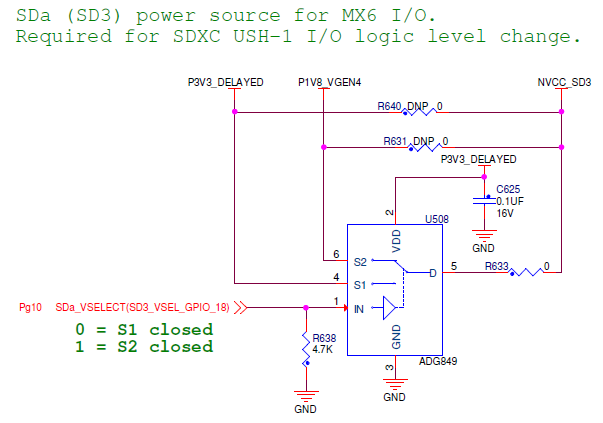

I need to configure ultra high speed sd card on custom board. Hardware for sd card is like sabre automotive sd card. So it has pin for switch 3V3 to 1V8. I tried with following configuration to enable ultra high speed for linux yocto kernel 3.14.28:

where vqmmc-supply is configured for 1V8 regulator with pin that switch the voltage. I am able to get high speed for sd card but not ultra high speed.
What is the right way to switch to ultra high speed?
Thanks, regards, Ivan.

according to SD specififcation host issues CMD11 to invoke voltage switch sequence.
By receiving CMD11, the card returns R1 response and start voltage switch sequence.
No response of CMD11 means that S18A (card indicates S18A=0, which means that
voltage switch is not allowed and the host needs to use current signalling level) was 0 and
therefore host should not have sent CMD11.
So that card does not support voltage switch or broken, one can try it once more on
Sabre AI board or use other card.
igor

ivanljubicic
Hi Igor,
I had wrong gpio for power switch and that is the reason why voltage was
not changed. So we have fix that and now power pin is triggered and card
again is not working doe to following reasons:
Switch for SD card is implemented as sabre automotive switch. The
difference is that 1V8 voltage is connected on pmic output SW4 which is
used for LPDDR2 memory. When we switch on board we see that voltage is
stabilized on 1V8, but when we start boot voltage is become 2V1. Do you
have any idea why is this happening?

ivanljubicic
Hi Igor,
I have connected protocol analyzer and measured commands toward SD card
and verse. Processor executes CMD11 to switch voltage from 3V3 to 1V8
but card does not response with R1 command and voltage is not switched
from 3V3 to 1V8. Clock stays on 3V3 and CMD also. Power switch is
defined as <&gpio1 17 GPIO_ACTIVE_HIGH> and stays always on 0. It should
probably switch to 3V3 but it does not happen. It seems that it is
configuration issue, but I am not able to figure out what. I have copied
configuration from sabre automotive board sd card, but it seems this
configuration fails. Is there example of configuration for sd card for
ultra high speed?
