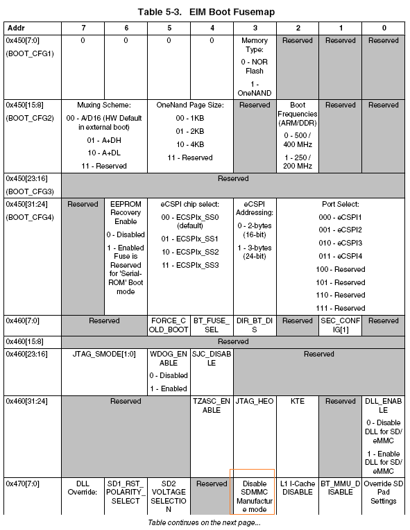

Hi Yuri,
I was wondering if you could tell me how to do these:
1. How to check the SD/MMC manufacture mode is enabled or not?
2. How can I read the value of this bit "Disable SDMMC Manufacture mode" on u-boot?
    md 0x470 1?
BR,
carter
1,222 Views
Yuri
   by default SD/MMC Manufacture Mode is enabled.
For access to the fuses - base address i.MX 6ULL OCOTP is 0x021B_C000.
So, 0x021B_C470 may be used for read.
