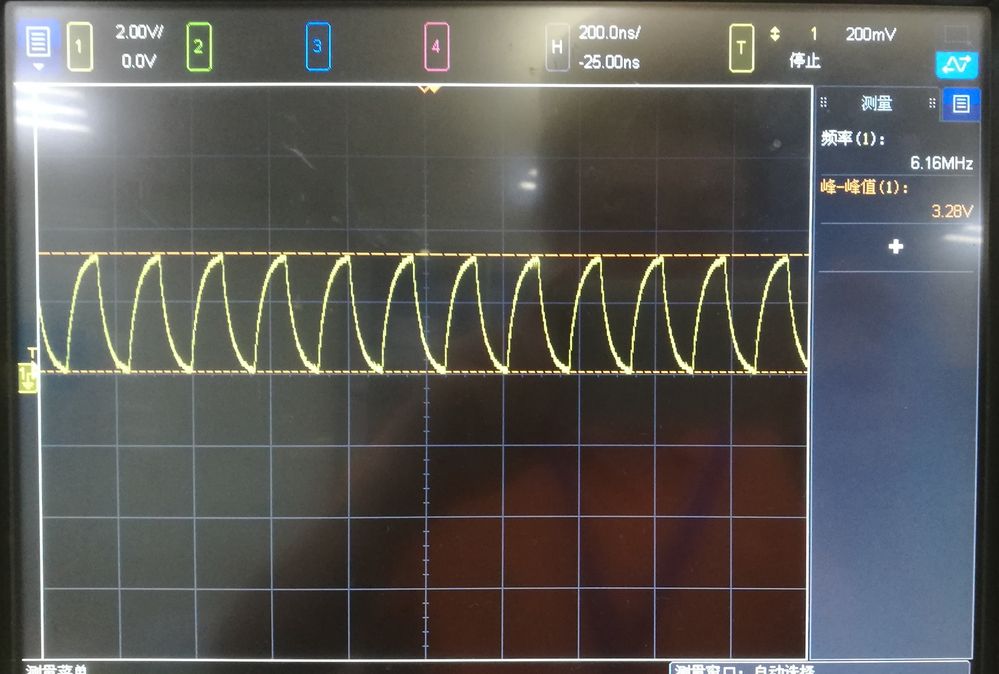

Hi all,
I'm developing beep audio feature with imx6g2 micro and used the SAI1 MCLK interface to output a reference clock for an audio converter (that is TI tlv320dac3100). My SAI1 mclk output is a waveform similar to a sine wave. Is it correct?
Here's my code to configure sai1 clock root.
const clock_audio_pll_config_t g_ccmConfigAudioPll =
.loopDivider = 30,
.postDivider = 2,
.numerator = 72,
.denominator = 100
/* Set SAI1 MCLK pin mux */
IOMUXC_SetPinMux(IOMUXC_CSI_DATA01_SAI1_MCLK, 6U);
IOMUXC_SetPinConfig(IOMUXC_CSI_DATA01_SAI1_MCLK,
IOMUXC_SW_PAD_CTL_PAD_DSE(7U) |
IOMUXC_SW_PAD_CTL_PAD_SPEED(2U));
/* Enable SAI1 MCLK output */
IOMUXC_GPR_GPR1 |= IOMUXC_GPR_GPR1_SAI1_MCLK_DIR_MASK;
/* Enable PLL4 608.64M */
CLOCK_InitAudioPll(&g_ccmConfigAudioPll);
/* Set SAI source to PLL4*/
CLOCK_SetMux(kCLOCK_Sai1Mux, 2);
/* Set SAI pre-divider to 6 */
CLOCK_SetDiv(kCLOCK_Sai1PreDiv, 5U);
/* Set SAI divider to 10 */
CLOCK_SetDiv(kCLOCK_Sai1Div, 9U);
And the following pic is my sai1.mclk waveform captured from the scope. Output frequency is 6.16MHz.MCLK.jpg

Hi Damon
sine waveform may be caused by weak drive strength and capacitive load,
one can try to increase drive strength using DSE field in
SW_PAD_CTL_PAD_x_y SW PAD Control Register described in IOMUX Chapter
of Reference Manual
igor

59174711
I tried your suggestion, but it didn't work. Before I set the DSE value to 7, I tried value 2 as you told me. The result is no change.

igorpadykov
one can also try to decrease mclk frequency.
