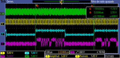

DigitalBrain
Hello, @Habib_MS
I've made some testing, changing 63U to 31U :
#define DEMO_SAI3_CLOCK_SOURCE_DIVIDER (31U)
and changing 24bits to 32bits:
#define DEMO_AUDIO_BIT_WIDTH kSAI_WordWidth32bits
makes it possible for the WS to achieve 192kHz without problems.
But when I change it back to 24 bits, WS goes up to 255kHz:

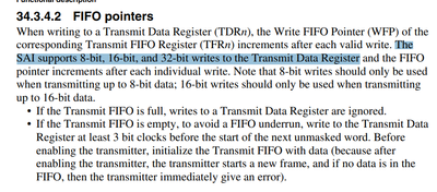

Maybe it has something to do with the word width being distinct to 8/16/32bits?

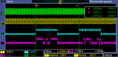

 (i.MX RT1024 Processor Reference Manual, Rev. 1, 02/2021, page 1582)
32bits@192kHz:

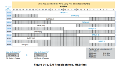

I've seen this image but I don't understand how should I configure this for 24bits:
 (i.MX RT1024 Processor Reference Manual, Rev. 1, 02/2021, page 1581)
Could you please indicate me how can I proceed?

The bit clock divider is calculated in the function called "SAI_TxSetBitClockRate", inside makes this formula:
Where if you set the source clock with a source divider of 31. This bit clock divider will be 2. that causes get more frequency in the WS and the BITCLK. However, if you configure the SAI3_ CLOCK_SOURCE_DIVIDER with 28 the clock divider will be 3.
Also, the next post explains the pictures that you provided me ((i.MX RT1024 Processor Reference Manual, Rev. 1, 02/2021, page 1581))

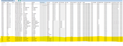

Here's the pinout for the SAI3 module
Configuration: 24bits, 192kHz and #define DEMO_SAI3_CLOCK_SOURCE_DIVIDER (27U)

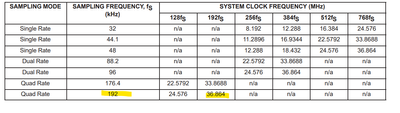

However, with this example the master clock is not configurated for PCM4104in, can you share me the datasheet of PCM4104in in order to know how are the requirements for Fs and MCLK?
Habib.
3,236 Views

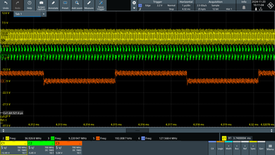

DigitalBrain
Hello, @Habib_MS
Indeed, the PCM4104 isn't compatible with that MCLK frequency.
I've achieved the next frequencies but still, not getting a clear sine wave at the output.
This is the configuration:
* AUDIO PLL setting: Frequency = Fref * (DIV_SELECT + NUM / DENOM)
* = 24 * (30 + 72/100)
* = 737.28 MHz
* = 737.28 MHz / 2 = 368.64 MHz
Then:
/* Select Audio/Video PLL (737.28 MHz) as sai3 clock source */
#define DEMO_SAI3_CLOCK_SOURCE_SELECT (2U)
/* Clock pre divider for sai3 clock source */
#define DEMO_SAI3_CLOCK_SOURCE_PRE_DIVIDER (0U)
/* Clock divider for sai3 clock source */
#define DEMO_SAI3_CLOCK_SOURCE_DIVIDER (9U)
/* Get frequency of sai3 clock */
#define DEMO_SAI_CLK_FREQ \
(CLOCK_GetFreq(kCLOCK_AudioPllClk) / (DEMO_SAI3_CLOCK_SOURCE_DIVIDER + 1U) / \
(DEMO_SAI3_CLOCK_SOURCE_PRE_DIVIDER + 1U))
So now it is divided by 10 and it goes down to 36.864 MHz
The frequency for BCLK:
 bitClockFreq = sampleRate * bitWidth * channelNumbers;
 bitClockFreq = 192,000 Hz * 24bits * 2 Channels
bitClockFreq = 9,216,000 Hz
Finally, the frequency of LRCLK succesfully gets to:
192kHz
