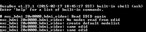

I am using the SABRE SDB platform and have loaded the Timesys files from their getting started page, but can't seem to get an output on my HDMI monitor.  I can get to the busy box terminal, but nothing on the HDMI screen.  If I disconnect and reconnect the screen, I get the message that is shown below:HDMI capture.JPG.jpg

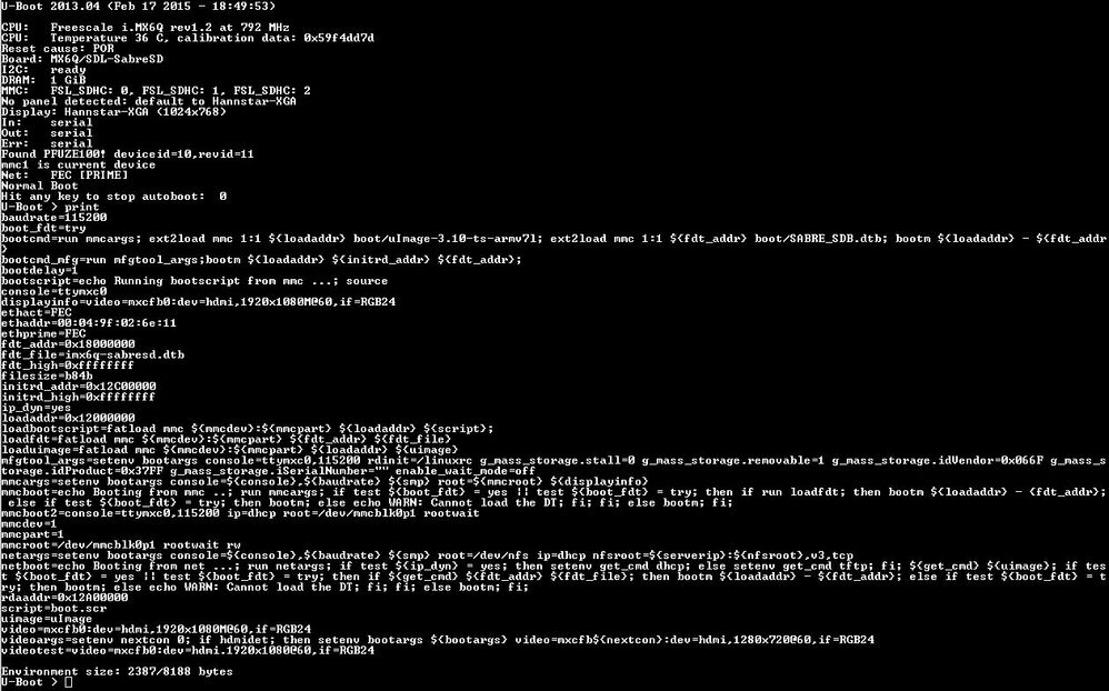

I will post the printout from Uboot below:
Any Help would be greatly appreciated.

Hi Joseph
suggest to check with Freescale Demo images on link below
http://www.freescale.com/webapp/sps/site/prod_summary.jsp?code=RDIMX6SABREBRD&fpsp=1&tab=Design_Tool...
L3.0.35_4.1.0_DEMO_IMAGE_BSP    L3.10.53_1.1.0_iMX6QDLS_Bundle
also are you using  "True" HDMI display ? (with special HDMI cable), not
just a HDMI - DVI adapter. In general one can also try other HDMI panel.
