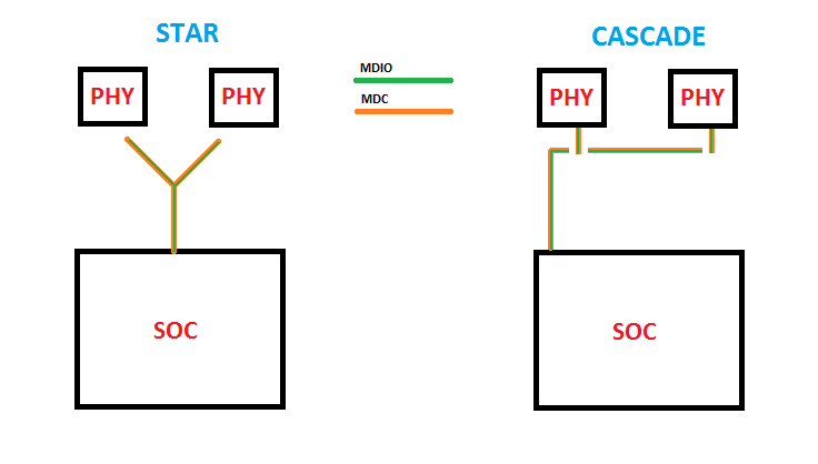

What its better to route MDIO MDC signals shared by 2 Enet Phy IC´s
Star or cascade (star = same lenght from soc to Phys) or cascade (thereis one phy before the other)

Hi Nacho
these signals are not high speed signals so any option
will work fine. Common guidelines can be found in sect.
3.16 Component placement recommendations i.MX6 System
Development User’s Guide
http://www.nxp.com/docs/en/user-guide/IMX6DQ6SDLHDG.pdf
igor
