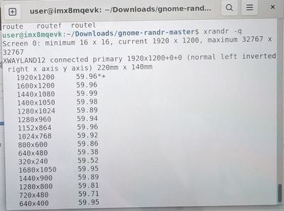

I'm trying gnome desktop on imx8mq and I want to use xrandr to rotate screen.
When I use this command, there is no effective on screen.
xrandr -o right
Another question is that I found the connector is XWAYLAND but is not DP-1. Because my panel is DP connector.

If you are using yocto, the MX8MQ does not use X11, it use wayland.

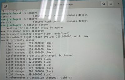

I have added this extension and the auto-rotate icon appear on screen.
The iio device is work when I use monitor-sensor to check it.
But the screen can not rotate and there is no effective on screen.
Has anyone encountered this problem?
