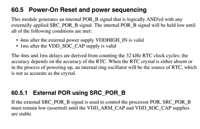

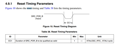

I have gone through the datasheet of i.MX6 processor and found that it reset time period is 4 msec, is it right? if yes, then what is the Rise and fall time of reset signal of i.MX6 processor.
Sanjay
664 Views
Manuel_Salas
Hello @SanjayGadkari
Please refer to chapter 60.5 and 60.5.1 of Reference Manual:
Also in 4.9.1 of datasheet:
