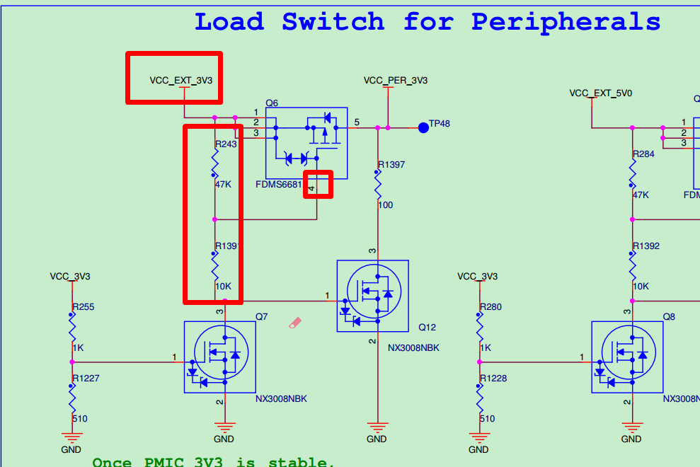

Resistor divider not accurate of Load Switch for Peripherals on i.MX8QXP MEK board.

Can you help to give a explaination on it?

Hi Wen,
   Vgs=3.3x10/(47+10)-3.3 = -2.72V

Hi Rita,
The worst case to OPEN this PMOS shoule be VGS<-3V, if we only have a -2.7V on Gate pin, the MOSFET will keep closed. So this circuit will not work. Please check, Thanks!
