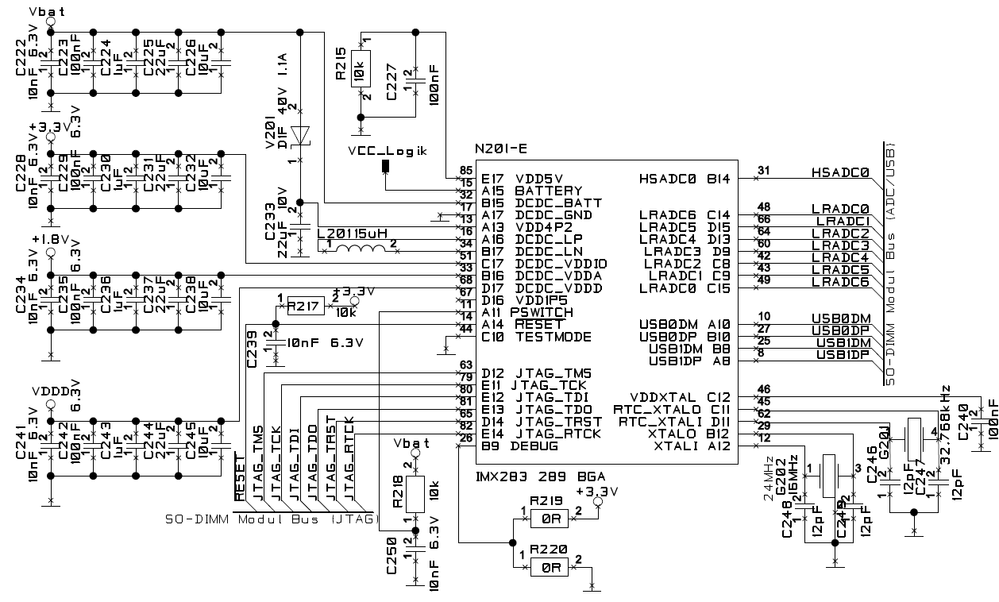

We supply our borad over the DCDC_BATT Pin with 3.3V (from DCDC). We use following configuration:

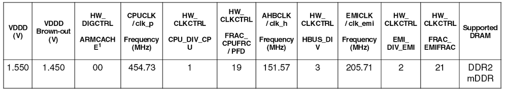

When the borad powerd with 3.3V we have a reset during the barebox is starting. We can increase the FRAC_CPUFRC to 28 or HBUS_DIV to 8 and the Linux starts normally.
When we power our board with 3.8V we have no problems. The Linux starts with the fastest clock configuartion.
Vbat and VCC_Logik (confusing name I now) are connected. What is the problem?
Peter

Yes, You may look at Table 13 (Power Supply Characteristics) of the Datasheet
(IMX28CEC, Rev. 3, 07/2012) :
DCDC_VDDA Maximum Output Current (VDDA = 1.8 V)  = 200 mA
~Yuri.

According to footnote of Table 8 (Recommended Power Supply Operating Conditions)
of the i.MX28 Datasheet(s) :
"With external loadings (for example, one DDR2 device and SD Card/NAND Flash),
MX28 PMU was tested at BATT/DCDC_BATT > 3.30 V
So, BATT/DCDC_BATT > 3.30 may be recommended.
Yuri

In the case, the issue may be caused because of really high (external) load.
Also, special software configuration should be applied here ; please take a look at
section 4.1.1.2 (DCDC_BATT source only: software configuration)  of the app note AN4199.
http://cache.freescale.com/files/32bit/doc/app_note/AN4199.pdf
~Yuri.
