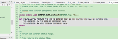

BTW, you can debug your code, make sure your this code is running:
PMC->OSTIMERr |= PMC_OSTIMER_SOFTRESET_MASK;
PMC->OSTIMERr &= ~PMC_OSTIMER_SOFTRESET_MASK;
You see, code is dark.
I think you can comment the #if #endif.
