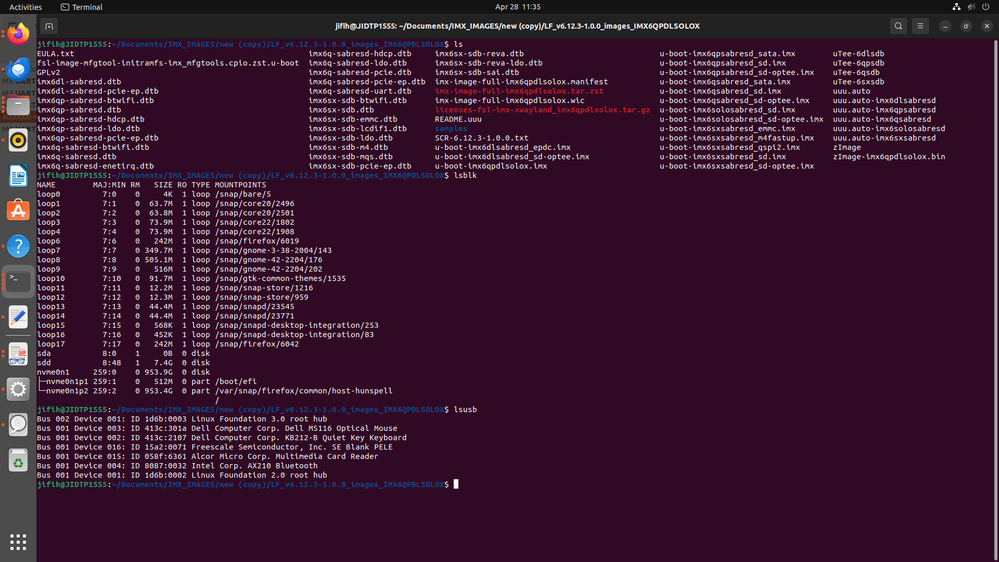

Ajay333
The other method we have tried flashing the uboot, zimage, dtb and rfs to the corresponding partition still the issue persist.
843 Views
Ajay333
We have tried flashing the latest full image MX6QDLSOLOX (imx-image-full-imx6qpdlsolox.wic) using balena etcher, even though the mode of boot is through SD card, still the device is not getting booted, we have listed out the usb devices, only the blank detetction of the device is notified.Screenshot from 2025-04-28 11-35-20.png
