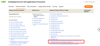

Rita_Wang
Hi @BDL-DNE ,
You can try to download newest Linux images to the board, it is easy to boot up:
Embedded Linux for i.MX Applications Processors | NXP Semiconductors
For android BSP, when download it need the admin limit.
Android Demo images are here :
Android OS for i.MX Applications Processors | NXP Semiconductors
Any questions contact me freely
