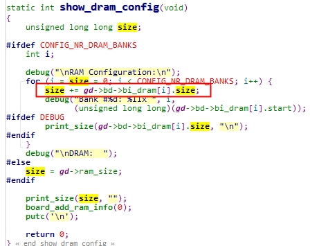

we modify the code as follow:
1. change the PHYS_SDRAM_SIZE to 4G:#define PHYS_SDRAM_SIZE       0x100000000
2. get the lpddr4_timing.c file  by MSCALE_DDR_Tool.exe tool and the MX8M_LPDDR4_RPA_v24.xlsx with new ddr chip params
we debug the uboot souce code,  it boot fail when the size += gd->bd->bi_dram[i].size  of the show_dram_config is executed          pastedImage_3.png
By the weay
 if we change the PHYS_SDRAM_SIZE to 3G #define PHYS_SDRAM_SIZE       0xC0000000,
 the uboot can run normally;
What's the reason?

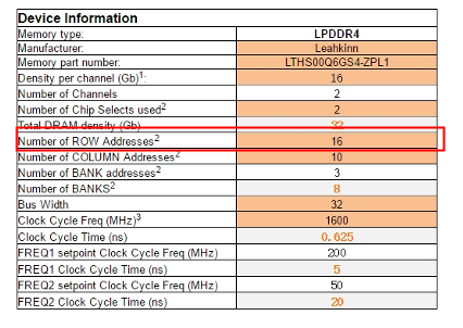

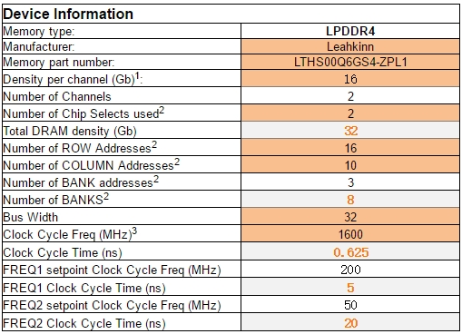

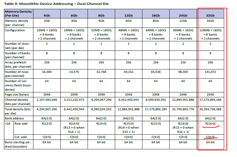

  There is another question need your help.
   the params of the Number of ROW Addresses is 16 or 17, which is inputed ?
   as the below 32G be used (32gb, R[16:0],c[9:0]),
Beset Regards
feng
