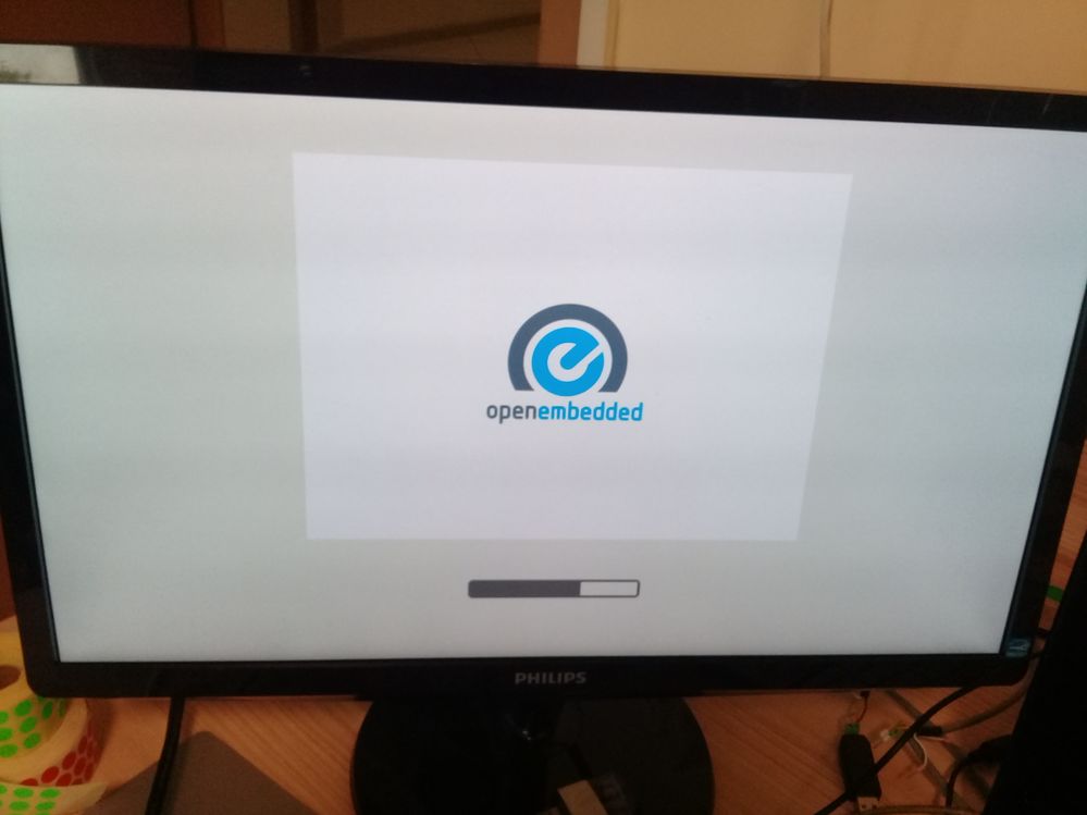

Hello Guys;
I want to remove the yocto project loading screen from the image . I couldnt find any way to this . Would it be possible to remove from perminently from the  U-boot console or directly from the image ?

mustafabakircio
Hi @nandish gurulingappa
At this directory  source/poky/meta-yocto/recipes-core/psplash you can change the plasplash_git.bbappend file or you can delete it . But when I do that I faced with this image , it so funny :smileygrin:
I thing there are more about psplash image in /source directory. You need to check them and delete after that it could be done I guess.
