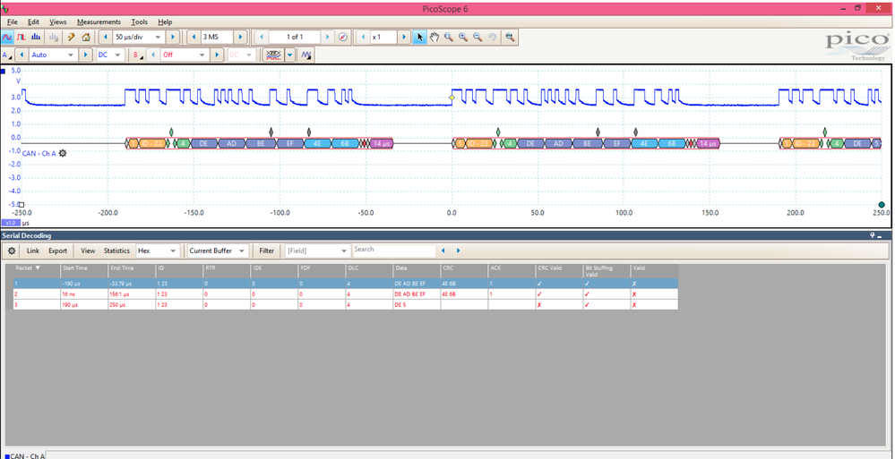

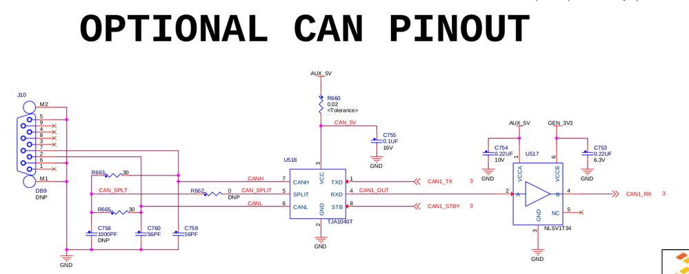

Please follow below mentioned steps to enable the CAN interface on i.MX6Q SABRESD board.
  • Populate R662 Register to stabilize CANH and CANL output signals.
  • Pin connection of CAN interface with i.MX6Q Processor is shown as below.
  • CAN_TX:
    • CAN_TX signal is connected between i.MX6Q Processor and CAN transceiver pin 1.
    • CAN_TX pin is GPIO_7 of P5 port of i.MX6Q Processor.
    • CAN_TX pin is defined as MX6QDL_PAD_GPIO_7__FLEXCAN1_TX Macro in i.MX6Q SABRESD Board DTS.
  • CAN_RX:
    • CAN_RX signal is connected between i.MX6Q Processor and CAN transceiver pin 4.
    • CAN_RX pin is GPIO_8 of P5 port of i.MX6Q Processor.
    • CAN_RX pin is defined as MX6QDL_PAD_GPIO_8__FLEXCAN1_RX Macro in i.MX6Q SABRESD Board DTS.
  • CANL_STBY:
    • CAN_STBY signal is connected between i.MX6Q Processor and CAN transceiver pin 8.
    • CAN_STBY pin is GPIO_19 of P5 port of i.MX6Q Processor.
    • CAN_STBY pin is defined as MX6QDL_PAD_GPIO_19__GPIO4_IO05 Macro in Macro in i.MX6Q SABRESD Board DTS.

After applying these modification, run following commands on i.MX6Q SABRESD Board terminal,
$ ip link set can0 up
$ ip link set can0 type can bitrate 500000
$ cansend can0 123#DEADBEEF
The CAN bus data captured in CAN analyzer between CANH (pin-7) and GND (pin-2) is shown as below:
