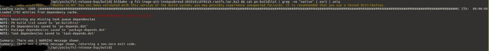

   The rootfs I generated with yocto was very large, and I carefully checked that there were a lot of debugging software    and other unrelated libraries that I didn't need. I want to trim the file system, but I don't know what instructions or    recipes I should run, please help me solve this problem.

You would need to replace <image> with the recipe for your image, not the resulting file system. In this example fsl-image-qt5.
You could just run:
$ bitbake -g fsl-image-qt5 && cat pn-buildlist
But for ease the command filters the packages maked as “native” and sorts them so they are in alphabetical order and only the unique results.

  • 1.  As you said, I entered the command line and it appears as follows:

The bitbake command should be run on the host while the bitbake environment is setup.

Which rootfs did you bake?
You could start from the bigger image and remove packages, or you could start from the core-image-minimal and add packages as needed.
If you need a graphical interface I would suggest the first approach, starting with the larger image with all required libraries and dependencies and removing the unwanted packages.
You can list all packages of an image with the command:
bitbake -g <image> && cat pn-buildlist | grep -ve "native" | sort | uniq
And then work from there removing unnecessary packages by adding the following line on the conf/local.conf file inside the build directory like so:
IMAGE_INSTALL_remove += “ package package1 package2”
I hope this helps!

I just tried using the following cmd-line, but an error occurred.
In addition ,Why look with the "native" parameter?
You could just run:
