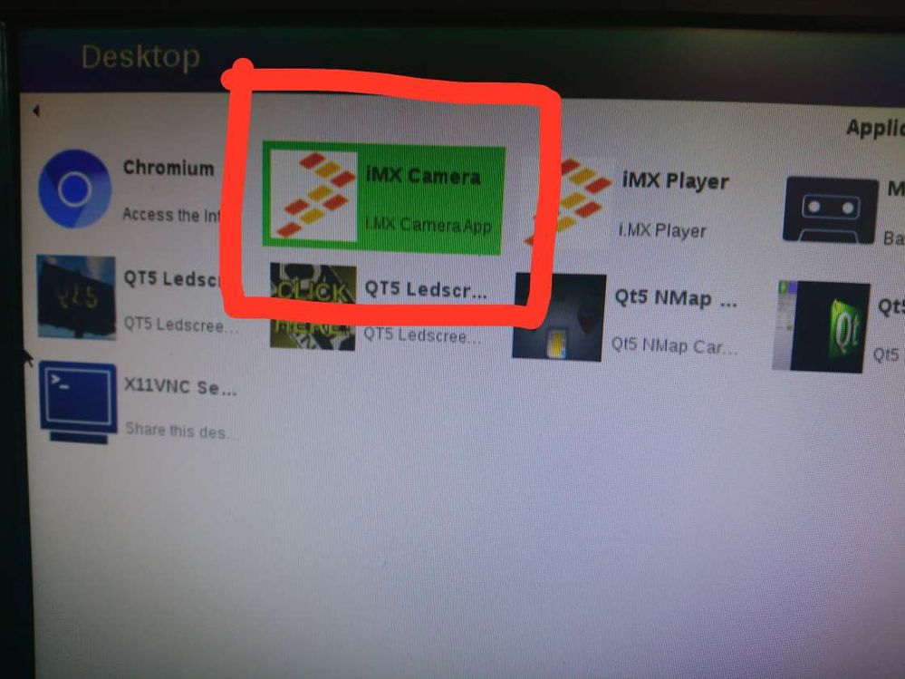

   Thank you for your response. But the article Video delay problem in Android is not compatible in my case. My video is not delay, FPS is stabled in 15. I don't complain about that. Which I wanna do is reduce initial time when I record. From moment I run program until video has been recorded is quite long about 3.6s. Example you press on record button but after 3.6 seconds later the time(00:00:00) is just started.

toanjunifer
Senior Contributor I
Hi igorpadykov‌,
Yes, I will try. BTW, I very interesting with this application. May you share it for me ?
