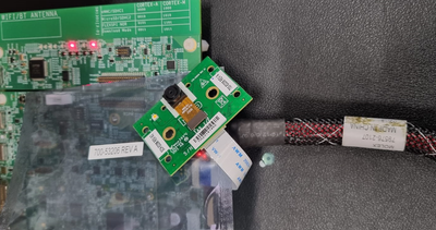

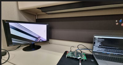

2,480 Views
Chavira
Hi @csenatore!
To use the camera is not needed any changes in device tree, the default device tree is working with the camera.
My outputs are the next:

root@imx93evk:~# gst-launch-1.0 -v v4l2src device=/dev/video0 ! "video/x-raw,format=YUY2,width=1280,height=800" ! queue ! waylandsink
Setting pipeline to PAUSED ...
Pipeline is live and does not need PREROLL ...
Pipeline is PREROLLED ...
Setting pipeline to PLAYING ...
New clock: GstSystemClock
/GstPipeline:pipeline0/GstV4l2Src:v4l2src0.GstPad:src: caps = video/x-raw, format=(string)YUY2, width=(int)1280, height=(int)800, framerate=(fraction)120/1, pixel-aspect-ratio=(fraction)1/1, interlace-mode=(string)progressive, colorimetry=(string)1:4:5:1
/GstPipeline:pipeline0/GstCapsFilter:capsfilter0.GstPad:src: caps = video/x-raw, format=(string)YUY2, width=(int)1280, height=(int)800, framerate=(fraction)120/1, pixel-aspect-ratio=(fraction)1/1, interlace-mode=(string)progressive, colorimetry=(string)1:4:5:1
/GstPipeline:pipeline0/GstQueue:queue0.GstPad:sink: caps = video/x-raw, format=(string)YUY2, width=(int)1280, height=(int)800, framerate=(fraction)120/1, pixel-aspect-ratio=(fraction)1/1, interlace-mode=(string)progressive, colorimetry=(string)1:4:5:1
/GstPipeline:pipeline0/GstQueue:queue0.GstPad:src: caps = video/x-raw, format=(string)YUY2, width=(int)1280, height=(int)800, framerate=(fraction)120/1, pixel-aspect-ratio=(fraction)1/1, interlace-mode=(string)progressive, colorimetry=(string)1:4:5:1
/GstPipeline:pipeline0/GstWaylandSink:waylandsink0.GstPad:sink: caps = video/x-raw, format=(string)YUY2, width=(int)1280, height=(int)800, framerate=(fraction)120/1, pixel-aspect-ratio=(fraction)1/1, interlace-mode=(string)progressive, colorimetry=(string)1:4:5:1
Redistribute latency...
^Chandling interrupt.
Interrupt: Stopping pipeline ...
Execution ended after 0:01:13.582441035
Setting pipeline to NULL ...
Total showed frames (4609), playing for (0:01:13.582263743), fps (62.637).
Freeing pipeline ...
root@imx93evk:~#
