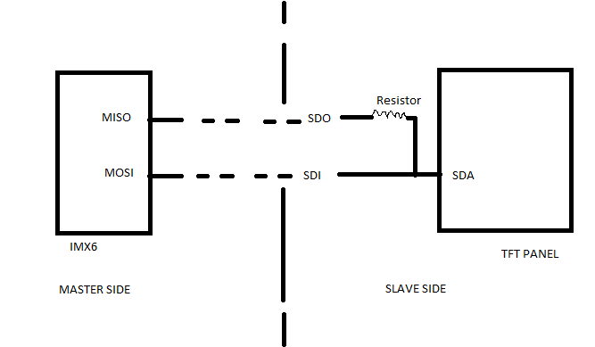

jamesdeepu
Dear Azlum,
I am also working on 3-Wire SPI. I read your posts. Can you clarify my doubts.
I have imx6 board with MOSI and MISO both Connected to SDI and SDO of LCD (Slave device).
On the slave side , SDO and SDI are connected together  where SDO is connected via a resistor
My query is
1) How will I tell linux kernel to use SPI-3 Wire mode
2) As per your previous discussion, MOSI should be connected via a resistor.?
3) In my case MISO is connected to SDO which is connected to SDI via a resistor(different from your case). Will that work out?
4) Bitbanging is only required if I don t connect MOSI to MISO via a resistor ?
Thanks in advance

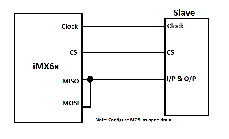

mohammedazlum
Hi Yuri,
i.e iMX6 SPI MOSI and MISO short together and configure MOSI as open-drain mode. In other words, SPI with MOSI open-drain mode.
What about MISO ? No need to configure as anything ?
Based on your input I modified my wiring diagram. Can you review the same ?
Azlum

Yuri
Correct, no need to configure input.
Yuri.

mohammedazlum
Hi Yuri,
When MOSI drive signal, the same signal can be feed into slave input and MISO of master. Is it create any problem or conflict ?
Azlum
11,936 Views
Yuri
I do not think so.
~Yuri.

mohammedazlum
Hi Yuri, Thank you for the reply....
After configure MOSI as open-drain, do we need to use Bit-Banging Technique ?
Azlum
11,937 Views
Yuri
No bit-banging needed. But pull up resistors (as for I2C) should be provided.
~Yuri.
11,937 Views

Yuri
  Assuming i.MX6 is SPI master, You may configure its MOSI output as open drain one
(via ODE bit field of corresponding IOMUXC_SW_PAD_CTL_PAD register) and
connect together i.MX6 MOSI, MISO and external SPI device I/O [I/P & O/P].
If needed, external device I/O should be configured for open drain too.
  When configuring GPIO, the Processor Expert for i.MX  may be useful.
