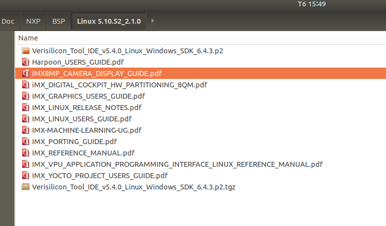

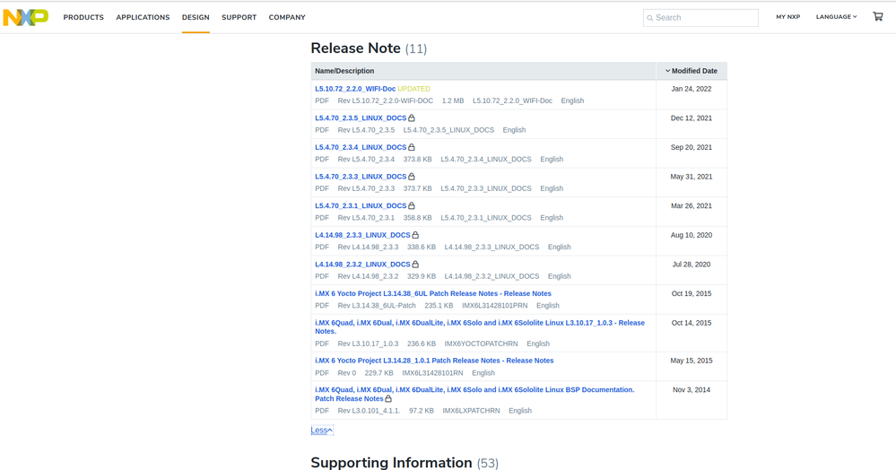

I think that you can find the necessary document in the release note package for iMX (tab Documentation --> Release Note) :
After downloading extracting the selected version of iMX Linux release, you will find a file name iMX8MP_CAMERA_DISPLAY_GUIDE.pdf :
