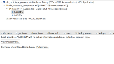

As I am debugging my RTWDOG timer on an RT1020 I am running into an issue. Whenever I run my tasks as I expect and refresh my RTWDOG, they work fine. However, if I forcefully try to have the RTWDOG fail and reset my MCU, it fails and gives me this error message:
I am debugging using "Debug using LinkServer probes" and flashing the code to my RT1020 board, and I initialize the RTWDOG in my main() function after the Board config functions and before I create my freeRTOS tasks.
This is my current RTWDOG configuration, where I set debug and the other debug configurations to false, as I am flashing to my board:

What can I change to have my RTWDOG reset my MCU automatically and not give me the thread suspension issue? I based my implementation on the rtwdog example provided by the SDK, and after I ran that I got the same thread suspension. Is it an issue with how I am debugging or something in the code is configured incorrectly?

Hi @ikuzmych,
You mention that the example code also results in thread suspension, and loosing of the debug session. This means that you don't see the example messages on your terminal window? If you look into the example project, under "doc" you can find a read me with three Note sections. Please look into these notes and make sure you are following them correctly.
