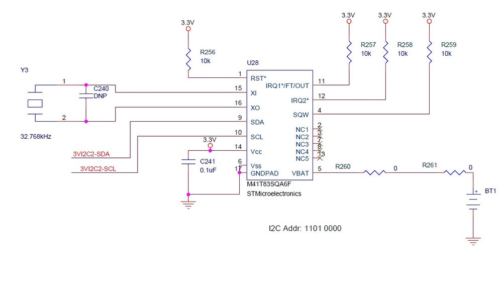

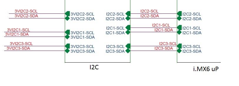

jaymind
Hello ,
As per suitable way also another word that one of the way for RTC interface with i.MX6 is that use good RTC chip (e.g. IC M41T83SQA6F STMicroelectronics) which is good and also suitable and working way.
Battery which connect to RTC chip is about to 3.5V Lithium coin cell.
This chip is work on serial I2C protocol and connect to uP via I2C interfacing.
some circuit connections and image show below.
RTC chip to uP connections
May above information helpful to you.
Jaymin D
