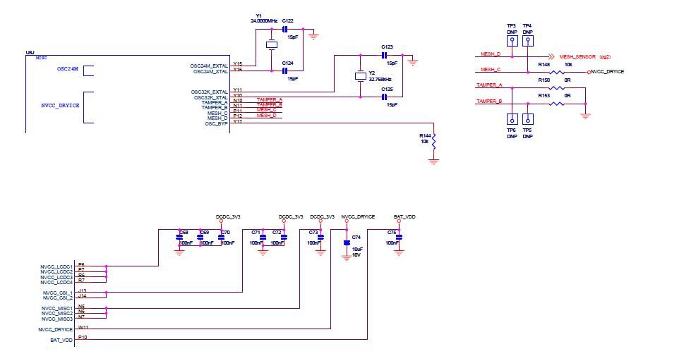

I'm using a i.MX25 in a custom board and facing problems with internal RTC, the DryIce Timer Counter. When processor is only supplied by BAT_VDD (1.2V), DTCMR (DryIce Time-Counter MSB Register) is not updated, I mean, time is not counted.
I'm printing DSR (DryIce Status Register) value during the beginning of rtc-imxdi module probe and having both SVF (Security-Violation Flag) and NVF (Non Valid Flag) disabled.
Disconnecting my board main power supply, I can verify that NVCC_DRYICE is 1.2V and the oscillator connected on EXTAL32K and XTAL32K is ok.
How can I have RTC working properly? Is there something missing?

Note, the Freescale PDK does not meet all requirements for correct RTC  operation.
As known, for i.MX25 RTC reliable operations it is needed  :
- to increase NVCC_DRYICE decoupling capacitance (~10uF, 4.7 uF as minimum).
- special power up sequence should be provided.
For new power up sequence NVCC_CRM should provided first, therefore it is needed
to add separate scheme for it.
Old approach assumes that NVCC_CRM may be fed via 3.3V  common for NVCC_CRM,
NVCC_CSI, NVCC_SDIO, NVCC_NFC, NVCC_JTAG, NVCC_MISC, VDD_I2C, VDD_EMI_DATA,
VDD_EMI_ADDR, NVCC_ADC OSC24M_VDD, USBPHY1_VDD, USBPHY2_VDD.

leonardoalmeida
Thanks, Bruno and Karina.
I'm updating with some data.
This is hardware from imx.25 BSP:
This is our customized hardware:
Mateus has done everything Yuri has suggested. The Freescale KIT and our board have the same problem, the RTC is lost after some time the board is powered off.
We've made some tests in our board. Into u-boot, it was added init_sequence for printing dryice registers, just after display_banner function. The data collected is:

Yuri
Just to clarify the problem : is the erratum (ENGcm11122 DryIce: Unexpected Reset) fixed in the case ?
I mean :
A) Special power up sequence should be provided additionally.
Please look at section 3.2.3 (SRTC DryIce Power-Up/Down Sequence) of the recent
datasheet IMX25CEC.
< http://cache.freescale.com/files/dsp/doc/data_sheet/IMX25CEC.pdf >
B) NVCC_DRYICE decoupling capacitance (~10uF) is provided.
4,902 Views
Balconi
Hi, Yuri.
SRTC DryIce Power-Up/Down Sequence is ok, board was designed following this orientation. And NVCC_DRYICE decoupling capacitance (~10uF) is also provided.
Is there another thing that I must look for?
Balconi.
