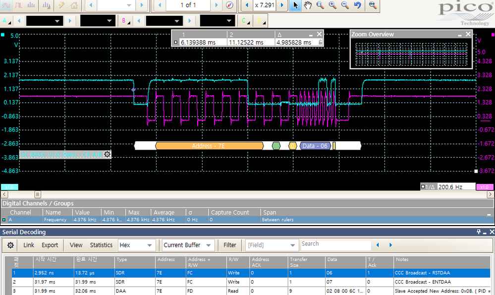

Hello.
I'm implementing CCC transfer between RT685 and ST's LSM6DSO.
The below image is what I expected. I tested other equipment. Broadcast 'Reset DAA'
Here's my code. I didn't use ISR. MINTSET register set 0x8AF00.

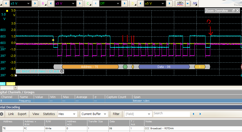

I thought, It look normal but there was not exist Ack part of 0x7E. So, It was not complete clearly, abnormal STOP.
How to fix it?

I recommend using the example master and on the other board the example slave. The ACK part is answered by the slave, please review the examples.
Pavel
