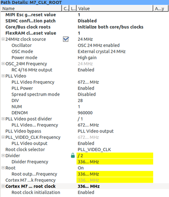

Trying to initialise the SEMC when the M7 core runs with a high clock frequency does lead to a crash of the CPU that I can't recover from (even JTAG doesn't work anymore). A power-cycle is required.

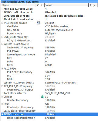

I have set up access to an external SRAM and an exteran SDRAM. Both access work when having the M7 core clock configured to 336 MHz and the SEMC clock to 198 MHz (no SEMC configuration patch). Changing the configured M7 core frequency of the project to 672 MHz does lead to the aforementioned crash.
All clocks are configured once on startup:
SEMC clock config from the MCUXpresso Config Tools:
Working M7 core clock config:
Core M7 clock config that leads to the crash:
