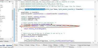

OK I understand the demo now - I was looking at the wrong pins - my bad.
So now I am calling  LPI2C_MasterTransferBlocking to read 315 bytes of data from an M24c64 eeprom device, and it appears to be getting stuck after reading 256 bytes - sitting in an endless loop awaiting data that is not transmitted.
lpi2c_master_transfer_t xfer;
xfer.flags = kLPI2C_TransferDefaultFlag;
xfer.slaveAddress = part_addr;
xfer.direction = kLPI2C_Read;
xfer.subaddress = 0;
xfer.subaddressSize = 2;
xfer.data = data;
xfer.dataSize = 315;
if ( LPI2C_MasterTransferBlocking(I2C, &xfer) == kStatus_Success)
If I manually split the read into 255 bytes followed by 60 bytes then it works OK. So it appears the logic in the fsl_lpi2c.c driver has a bug reading over 256 bytes.
Is this known issue? Is there a fix available?

kerryzhou
Hi @VicKrawciw ,
  If you check the driver detail code, you will find it:
Make sure your transfer data is not exceed the max size.
You also can debug it find the root issue.
Wish it helps you!
kerry
8,028 Views
VicKrawciw
315 bytes does not exceed this limit which would be 256*4.
I have tried to debug it but the device just stops at 256 bytes. I cannot determine if the problem is actually in the LPI2C hardware as I can see no reason for the apparent failure to move on to the next read command in the MTDR command fifo. Two read commands are placed into the MTDR fifo (0x1ff, 0x159) but it appears that no more reads are placed on the I2C bus when the first command completes, which causes the the read of the MRDR register to have the RXEMPTY flag set - and the code just loops expecting this situation to change - which it does not as reads are not happening on the bus.

VicKrawciw
I have no need of the interrupt version in my project - the polling version is sufficient.
As I mentioned during my debug, there is no error returned - it fails to move on in the fifo to the next read command and so just repeatedly attempts read values from the MRDR which returns empty.
LPI2C_MasterTransferBlocking calls LPI2C_MasterReceive which is where the issue arises.
It is stuck in this loop:
uint32_t value = 0U;
do
/* Check for errors. */
result = LPI2C_MasterCheckAndClearError(base, LPI2C_MasterGetStatusFlags(base));
if (kStatus_Success != result)
break;
value = base->MRDR;
#if I2C_RETRY_TIMES != 0U
waitTimes--;
} while ((0U != (value & LPI2C_MRDR_RXEMPTY_MASK)) && (0U != waitTimes));
if (0U == waitTimes)
result = kStatus_LPI2C_Timeout;
#else
} while (0U != (value & LPI2C_MRDR_RXEMPTY_MASK));
#endif
I am sure LPI2C_MasterSend will be OK as that just writes each byte of data to MTDR one at a time.

VicKrawciw
As far as I can tell it appears the master stops generating the clock in order to read the bytes of the following FIFO command to read bytes 257 onwards.
I have implemented a work around that splits the read into separate 256 byte LPI2C_MasterTransferBlocking calls adjusting the subaddress for each call.
