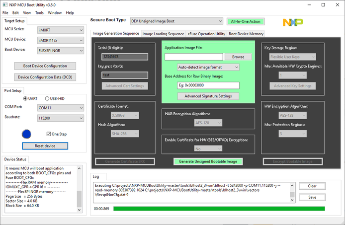

When I boot my computer, I start a command prompt (DOS box) and can see the board running blhost manually
C:\projects\blhost_2.6.2\bin\win>blhost -p COM11 get-property 1
Ping responded in 1 attempt(s)
Inject command 'get-property'
Response status = 0 (0x0) Success.
Response word 1 = 1258487809 (0x4b030001)
Current Version = K3.0.1
I can start MCU boot and "connect to ROM" with the nice sound effect upon completion
At some point something happens and if I reset the board, the command prompt get property is OK, but the MCU boot, closed and restarted, gets no response on blhost commands culminating in this message
And the MCU boot command window showing
Executing: C:\projects\NXP-MCUBootUtility-master\tools\blhost2_3\win\blhost -t 50000 -p COM11,115200 -j -- get-property 1 0
toolStatus: 1
commandOutput: {
"command" : "ping",
"response" : [],
"status" : {
"description" : "10500 (0x2904) No response received for ping command.",
"value" : 10500
The same command that works in the separately opened command prompt, running blhost manually.
The SW1 switches are correct or it would not have run the first time.
At this point. I can close MCU boot and rerun the command prompt blhost get property and still is OK, but MCU boot no longer works.
I have to completely restart my computer which makes me think something is still running in Windows that I need to kill in task manager.
Any ideas?
Dan

You can uncheck the 'One Step' option, then click 'connect to ROM' button step by step, that will be more stable for your case.

Actually, I also encounter the phenomenon you describe above, and the below error message will jump out sometime.
For me, I usually close the doc log window of MCU boot to kill the tool, meanwhile, repower the board to eliminate the issue.

Thank you. I always power cycle.
By doc log window you mean the second window that echo's commands that looks like a DOS window?
I always kill the main window and then sometimes have to manually kill the second one.
I noticied if I wait longer, it seems to work better too.
I switched to USB from COM port and the problem has not occurred.
Dan
