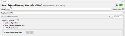

I'm trying to configure the RT1172 SEMC for SRAM using MCUXpresso Config Tools Version 13.1.
I only see SDRAM as an option:

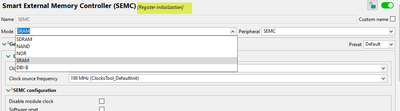

Omar_Anguiano
Hello
I hope you are well.
This feature is available in the standalone version of Config Tool, you need to make sure that SEMC is at "register initialization".
Omar

mjosborne1
Thanks for the info, I see the option now.
