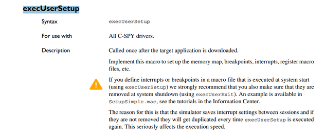

I am using MIMXRT1170-EVK Board, uart example for cm7.
I am trying to load the binary on the target using the cspy tool (through lpuart_polling_cm7.debug.cspy.bat). It loads and running as expected but keeps the command line open and it never terminates until ended by user.
I tried to add argument --download_only for the .out file, it loads the image but not execute it until I attach using IAR and press Go.
My questions:
1. How to use the cspy tool to load the binary image and execute it without any manual intervention?
2. How to add script to let the target execute it I used --download_only option? Here I am using CMSIS-DAP connection?
The uart project which is part of RT1170 SDK is attached.

Hi @AhmedHabib ,
The C-SPY macros might help you on this purpose, for example,
Please kindly refer to https://wwwfiles.iar.com/RX/webic/doc/EWRX_DebuggingGuide.ENU.pdf for more details.
Please kindly contact IAR for further support. https://www.iar.com/about/contact
