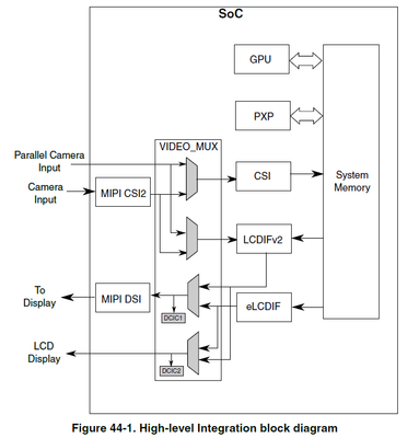

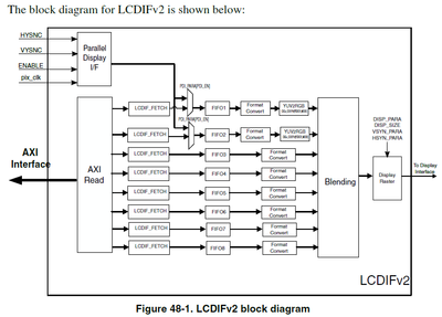

Dear NXP support,
As the following diagrams in i.MX RT1170 Processor Reference Manual, it seems that we can have a direct video flux from MIPI_CSI to LCDIFv2 then to MIPI_DSI.
But no such example in the SDK.
How to configure LCDIFv2 to achieve that ?

Aubineau_FAE
Unfortunately this features (direct path from camera input to the screen without memory access) has been removed.
It will be updated in the next Reference Manual release.
Vincent
