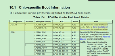

Hi @tepper ,
  Please check the RT1170RM, that is precise:
Just the UART1, and the pin in the above table.
