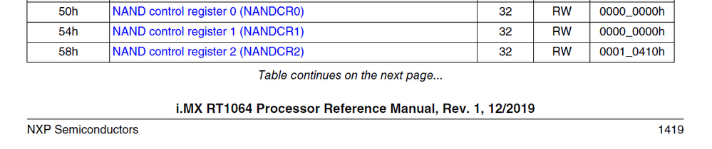

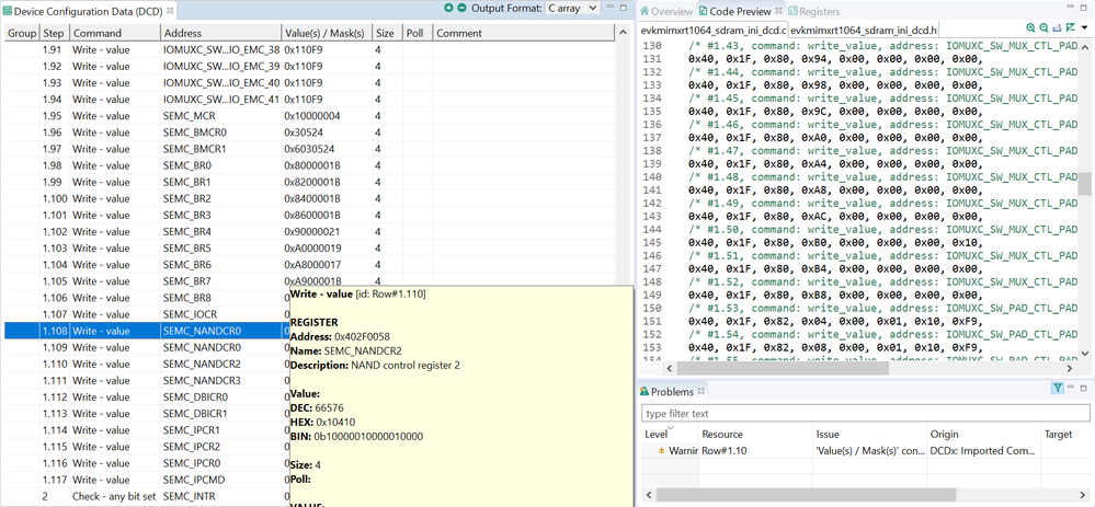

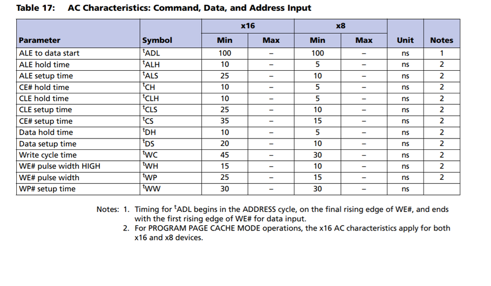

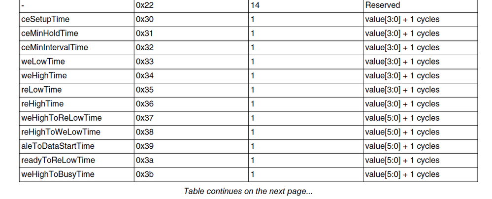

Sabina_Bruce
Hope you are well. For the SEMC NAND Control block I recommend to check table 9-17 of the reference manual. Here you will find the parameters to configure for your specific nand flash.
These parameters can be configured using the NAND Control Registers.
How these parameters are filled, depends on the information from the datasheet of the part you are using. For example I checked the parameters for a random nand flash.
The config tool allows you to configure the general configurations of the SEMC. You may configure the NAND control register using the DCD tool.
Hope this helps!
Sabina

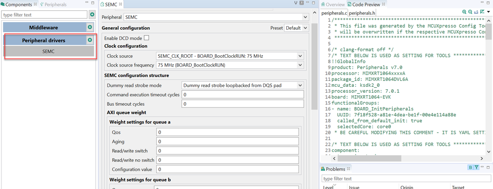

Sabina_Bruce
Hello Ernst,
Hope you are doing well.
If you would like to get started on example software. I'd recommend to download the latest SDK and import the corresponding examples for SEMC.
MCUXpresso Website
In addition you may use the peripheral config tool, to configure specific characteristics of the SEMC module to fit your application. This tool can generate the adequate C code, for faster startup process in your development.
Sabina
