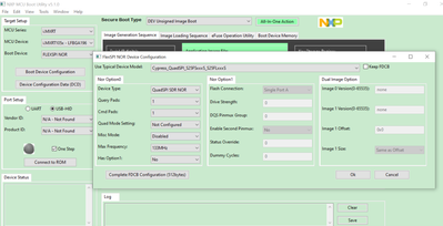

Hi @TomMarki-1 ,
    Check your board, if it can enter the serial download mode, use the MCUBootutility, whether it can be connected and download app or not:
https://github.com/JayHeng/NXP-MCUBootUtility/releases/tag/v5.1.0
the related user manual is:

3,994 次查看
TomMarki-1
Hi Kerry,
TY again for your expertise, I apologize for the hurdles our system poses with respect to Serial Download Mode.
Re the flexspi_nor_polling_transfer app, and its flash init struct customLUT[], can this be initialized with the evkbimxrt1050_flexspi_nor_config.c flexspi_nor_config_t qspiflash_config.memConfig.lookupTable from my project ?
Tom

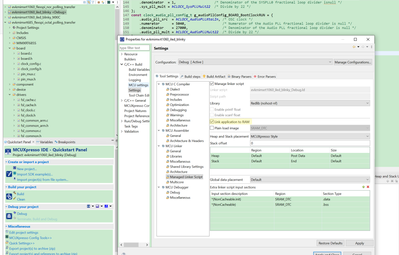

   When you use the new QSPI flash, please use this sdk code to test the external flash at first:
\SDK_2_13_0_EVKB-IMXRT1050\boards\evkbimxrt1050\driver_examples\flexspi\nor\polling_transfer
  Make sure the read, write, erase related function works Ok, it will make sure your hardware works.
  Then you can download the code to the app.
  When you test the polling_transfer, please download it to the RAM to test, as you can't make sure your external flash works.
  Take the mcuxpresso IDE as an example:
  If you still have issues, please use your company email to create the question post in stead of the 3rd part email, it will have higher support priority, thanks.
kerry
4,173 次查看
TomMarki-1
Good idea, TY,
In flexspi_nor_polling_transfer how can I specify my own 'flexspi_nor_config_t' ?
When I run it I see a failure at line 219:
"Program data - read out data value incorrect !\r\n "
I am trying to update my email address as well.
