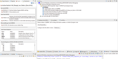

flash_component_nor:
Debugger starts but then a Fault occurs:

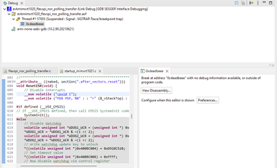

flexspi_nor_polling_transfer:
First execution the program is stucked at some point and it is not recovered, from now on if trying to launch the application again the debugger is not even starting:
To recover the device I need to connect it with 'NXP MCU Boot Utility' and perform a 'Connect to ROM' once.
