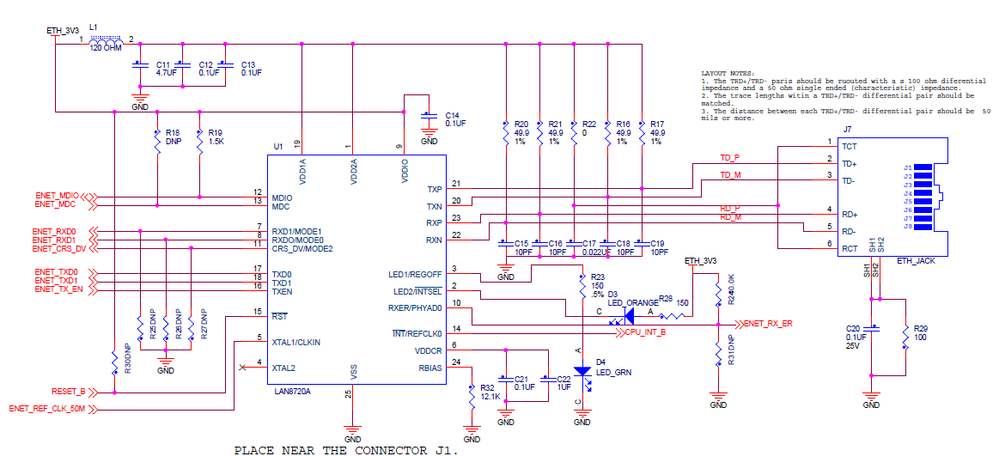

I can't get ethernet RMII interface to work on custom hardware with an IMX6Q and a LAN8720A.
Here are my schematics:
I have made the following changes to u-boot and the kernel. (Following Fugan Duan's patches Re: iMX6 RGMII + ENET_REF_CLK/ENET_TX_CLK)
dtra3 is the name of my custom hardware.
Here I'll just show my changes to u-boot to make the RMII interface work.  I'm using GPIO 16 as clock output for the phy.

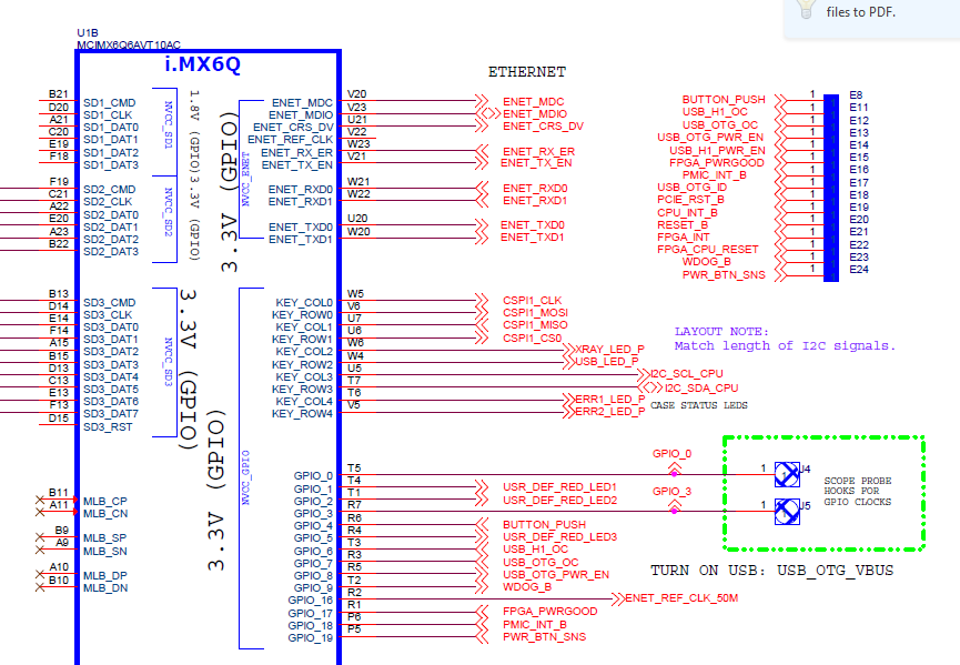

  MX6Q_PAD_NANDF_ALE__GPIO_6_8, /* wired to CPU_INT_B from the int/refclk0 pin on the LAN8720 */
  MX6Q_PAD_NANDF_CLE__GPIO_6_7, /* output connected to RESET_B to the rst pin on the LAN8720 */
  MX6Q_PAD_GPIO_16__ENET_ANATOP_ETHERNET_REF_OUT, /* wired to ENET_REF_CLK_50M to the clkin pin on the LAN8720 */

Other observations:
The valid link LED and activity LED both come up and the activity LED blinks during the ping operation. ENET_REF_CLK_50M is up and looks good, and ENET_MDC comes up during the ping command.  Otherwise it's not up.  With a scope I can see activity on all the lines RXD0, RXD1, CRS_DV, ENET_MDIO, TX_EN, TXD0 and TXD1 during the ping command.
Can anybody help.  Specifically why does the mii dump command throw and error?

snowman
We are having a similar problem with our custom iMX6Q-LAN8720A board.
1) We can't ping a host connected to the twisted pair interface through a short CAT5e cable.
2) We are running QNX however, we have also tried a modified U-Boot image and have the same results (failed ping).
3) Our connections are similar to your schematic except we are trying to use the REFCLK OUT mode on the LAN8720A. We have modifed a board to use the REFCLK IN mode, and use the 50 MHz generated by the MX6 on GPIO16 (as in your schematic) but have the same results.
4) Here is a dump of our PHY registers, can you compare them to your PHY registers? Your last post has PHY control register = ffff. Are you sure you are accessing the 8720A SMI correctly?
phy[ 0]:0x1000 phy[ 1]:0x7809 phy[ 2]:0x0007 phy[ 3]:0xc0f1
phy[ 4]:0x0de1 phy[ 5]:0x0001 phy[ 6]:0x0000 phy[ 7]:0xffff
phy[ 8]:0xffff phy[ 9]:0xffff phy[10]:0xffff phy[11]:0xffff
phy[12]:0xffff phy[13]:0xffff phy[14]:0xffff phy[15]:0x0000
phy[16]:0x0040 phy[17]:0x0002 phy[18]:0x60e0 phy[19]:0xffff
phy[20]:0x0000 phy[21]:0x0000 phy[22]:0x0000 phy[23]:0x0000
phy[24]:0xffff phy[25]:0xffff phy[26]:0x0000 phy[27]:0x0000
phy[28]:0x0000 phy[29]:0x0090 phy[30]:0x0000 phy[31]:0x0040
5) Your mac address (00.00.00.00.00.00) seems wrong. Are you sure all zero's will work for a MAC address?
6) How far apart (physically) is the MX6 and LAN8720A on your board? On our board they are over 4 inches apart and we have concerns about timing margin.
7) The I/Os between the MX6 and LAN8720A on our board are 1.8V. This should work but I see all other designs use 3.3V I/Os.
