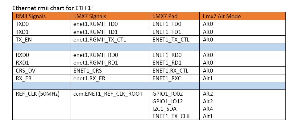

I'm trying to get a custom board with the IMX7 processor to talk RMII to my phy.
However, does the IMX7 fully support RMII?
Currently, I have the following device tree config:
&fec1 {
pinctrl-names = "default";
pinctrl-0 = <&pinctrl_enet1>;
assigned-clocks = <&clks IMX7D_ENET1_TIME_ROOT_SRC>,
<&clks IMX7D_ENET1_TIME_ROOT_CLK>;
assigned-clock-parents = <&clks IMX7D_PLL_ENET_MAIN_100M_CLK>;
assigned-clock-rates = <0>, <100000000>;
phy-mode = "rmii";
phy-handle = <&ethphy1>;
fsl,magic-packet;
status = "okay";
mdio {
#address-cells = <1>;
#size-cells = <0>;
ethphy1: ethernet-phy@1 {
compatible = "ethernet-phy-ieee802.3-c22";
reg = <1>;
If I change phy-mode rmii to rgmii, I see data being sent over the TXD lines. However, in RMII mode, TX_CTL is silent as wel as the TXD lines.

arnoutdiels
I tested our new hardware revision (with the correct RX_CTL pin), and RMII works now!
Thanks for the help Igor, and I hope the manual/datasheet gets updated to be less confusing in the future.
Kind regards,
Arnout
7,409 Views
arnoutdiels
Thanks, as I feared. We took the wrong pin. I hope this gets fixed in the reference manual soon.
Another note for anyone who would try to get stuck: It seems to be required in the device tree pinmux to set a pin with pinmux enet_ref_clkx, in order for it to be activated internally! (For example, I was trying to use enet_ref_clk1 for both eth0 and eth1, but eth1 simply is not active until -a- pin has the pinmux enet_ref_clk2 (regardless of whether it is connected to anything).
And yet another note: In case anybody would try to use two seperate MDIO busses (Sabre uses 1 for both phy's), you need to patch the driver to avoid it forcing this configuration.
Thanks igor for your support, and hopefully when we have a new hardware iteration ready, packets start flying happily!

arnoutdiels
I found it in the reference manual in Table 5-11. Clock Root Table. The clock mux has to be put to the 50Mhz.
I don't fully know how this has to be done in the device tree, but this patch did the trick:
diff --git a/arch/arm/mach-imx/clk-imx7d.c b/arch/arm/mach-imx/clk-imx7d.c
index 980a30a..d05e947 100644
--- a/arch/arm/mach-imx/clk-imx7d.c
+++ b/arch/arm/mach-imx/clk-imx7d.c
@@ -905,6 +905,9 @@ static void __init imx7d_clocks_init(struct device_node *ccm_node)
imx_clk_set_rate(clks[IMX7D_ENET_AXI_ROOT_CLK], 267000000);
imx_clk_set_parent(clks[IMX7D_ENET_PHY_REF_ROOT_SRC], clks[IMX7D_PLL_ENET_MAIN_25M_CLK]);
+ imx_clk_set_parent(clks[IMX7D_ENET1_REF_ROOT_SRC], clks[IMX7D_PLL_ENET_MAIN_50M_CLK]);
/* set pcie root's parent clk source */
imx_clk_set_parent(clks[IMX7D_PCIE_CTRL_ROOT_SRC], clks[IMX7D_PLL_ENET_MAIN_250M_CLK]);
imx_clk_set_parent(clks[IMX7D_PCIE_PHY_ROOT_SRC], clks[IMX7D_PLL_ENET_MAIN_100M_CLK]);
The packet transmission works now!
However, reception does not.
I fear that this might be due a wrong pin selection.
As mentionned before, Table 11-1 in the reference manual is missing RMII pin information. Like the TX_EN was not mapped anywhere clearly, the CRS_DV for RMII is also nowhere to be found.
For our reference board, we mapped this onto ENET1_CRS, but who knows, perhaps it had to be RGMII1_RX_CTL?
Igor, since you knew about the TX_EN, can you confirm which pin it has to be for the CRS_DV?
Thanks in advance for your reply!

igorpadykov
Hi Arnout
you are right regarding TX_EN pin, for linux settings one can look
at Colibri iMX7 linux with Micrel KSZ8041
https://github.com/Freescale/u-boot-fslc/blob/2016.07%2Bfslc/include/configs/colibri_imx7.h
http://git.toradex.com/cgit/linux-toradex.git/tree/arch/arm/boot/dts/imx7-colibri.dtsi?h=toradex_imx...
igor
