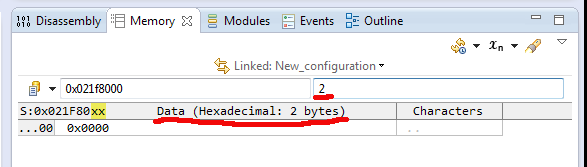

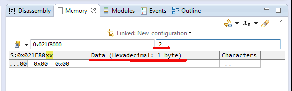

Hi All,
Currently using a RIoTboard (i.MX6S based SBC) for bare-metal programming. Have come across a peripheral access error (doc with problem description and basic code attached) with regards the I2C (and UARTs). I am probably missing some sort of configuration setup, but for the life of me I cannot figure out what!
Very briefly, (more details in the doc) I am using ARM DS-5 and when I try to access the I2C modules (via the debug interface) I get a synchronous external abort (I experience the same problem with the UARTs). I am using the default clock setup so the peripheral clock (ipg_clk_s derived from ipg_clk_root) for peripheral bus register read/writes should be running. I have enabled all gated clocks as part of an initialisation script (all in attached basic code).
The problem has me stalled at the moment and I am keen to sort it out. Any and all help on the matter would be much appreciated.
Thanks in advance.
Original Attachment has been moved to: CortexA9MPCore-Startup.zip
2,013 Views
jamesbone
I2C peripheral is mapped to the memory and when debugger trying access this area as 32bit word, cpu raise exception - debugger try access memory area as 32bit size words, but I2C registers are 16bit words. For fast test, try read 2Bytes (16bit) or 1Byte only from I2C register address.
