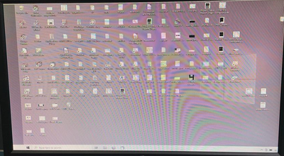

I am using RGB888 format, Image is displaying in HDMI port but strips are adding in image, I am thinking some bits are missing. Please help us to resolve this Issue. I am getting Image as below.
Thanks & Regards,
Mallikarjuna B.
