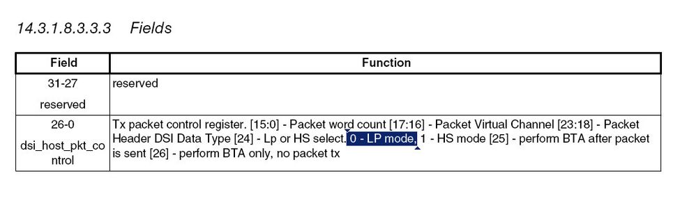

igorpadykov
Hi sujin
LP mode can be set in the register DSI_HOST_PKT_CONTROL as shown below:

sjkim
Thank you for answer.
Oh!
Where can I set this?
I can't check it in my documentation.
Can you link to the relevant source code or documentation?
Please answer.
Thank you.
2,684 Views
igorpadykov
one can try to set in driver code: panel-raydium-rm67191.c\panel\drm\gpu\drivers - linux-imx - i.MX Linux kernel
