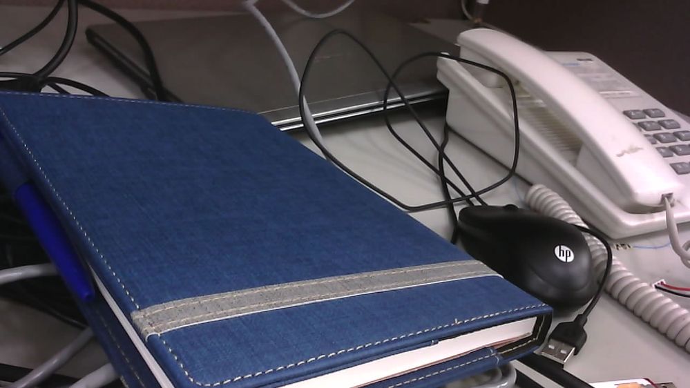

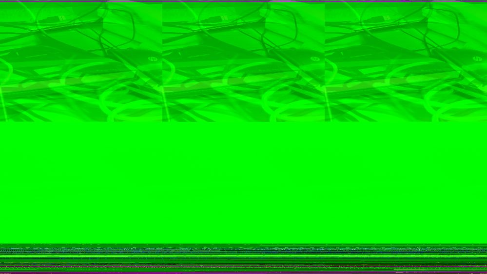

case 2: 1920 x 1080, sometimes camera app crash, and sometime get wrong image as below
case 3: 1280 x 720, the picture is correct
