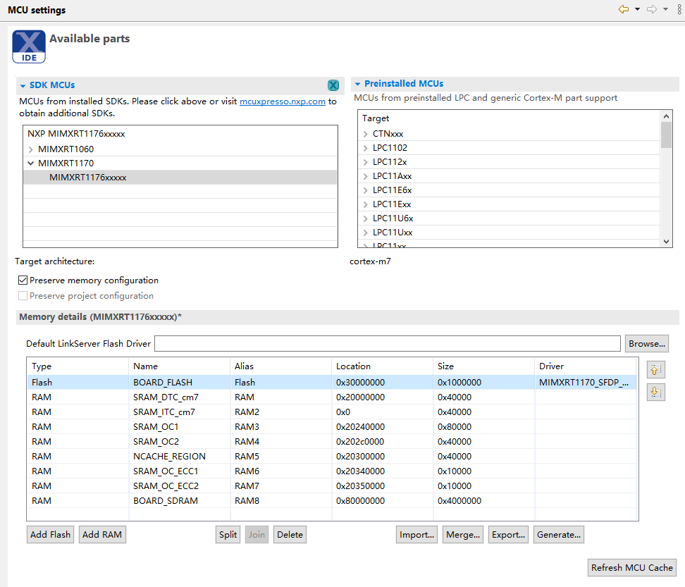

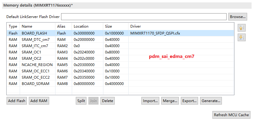

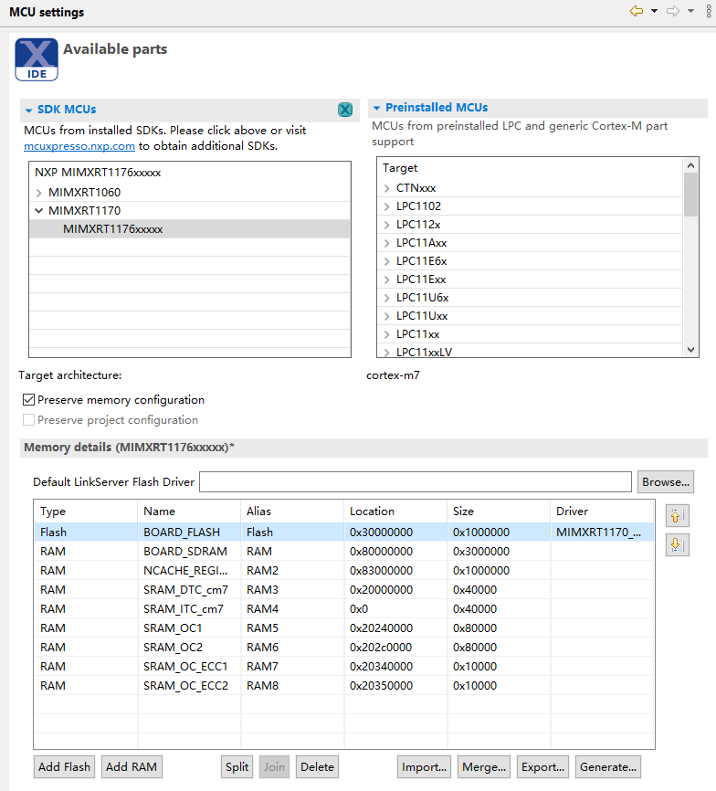

Hi there,

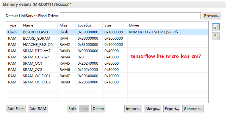

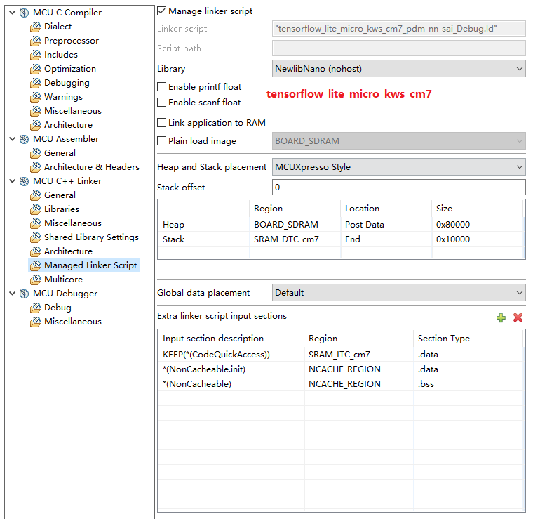

I'm now trying to add an algorithm between PDM-MIC and SAI-headphone(based on pdm_sai_edma_cm7 Demo in SDK 2.11.0), but the default MCU Memory Settings is not enough for an algorithm with MFCC. So I try to set the MCU Memory the same with another Demo(tensorflow_lite_micro_kws_cm7 in SDK 2.11.0), which also uses algorithm with MFCC.
pdm_sai_edma_cm7_memory_setting.PNGpdm_sai_edma_cm7_memory_setting2.PNGtensorflow_lite_micro_kws_cm7_memory_setting.PNGtensorflow_lite_micro_kws_cm7_memory_setting2.PNG
But then, when the Debug is finished, the MCU will directly be locked. So I'd like to ask, is there any Documents or tricks for setting Memory? In RM I only find a Memory Map, it only shows which addresses are reserved, which are available.
Thanks and Regards!
Shawn

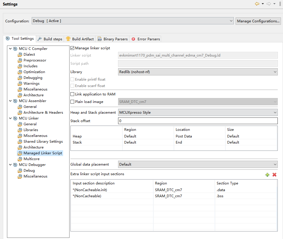

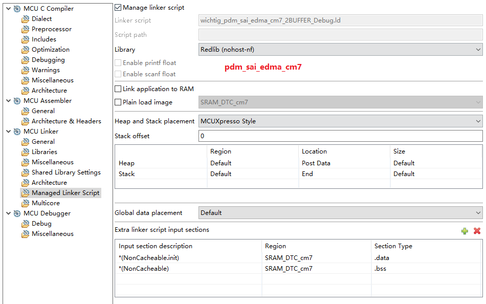

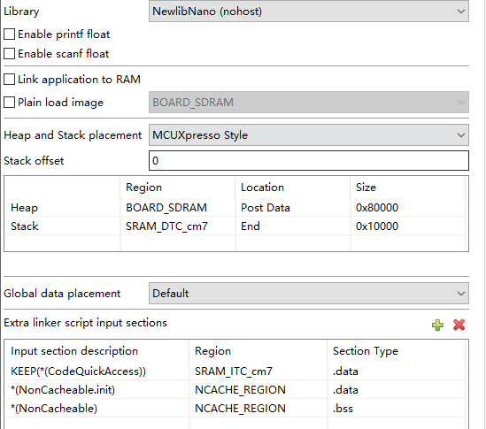

Shawn_
thanks for your anwser. The following 2 figures show the original MCU Memory Settings, also the default Settings of pdm_sai_edma_cm7 Demo:
Then, what I changed is shown in the following 2 figures, it is just the same as the memory settings of tensorflow_lite_micro_kws_cm7 Demo:
After that, MCU is always locked, when Debug is successful.
Thanks and Regards
Shawn

jeremyzhou
Thanks for your reply and clarification.
To enable the SDRAM, it needs to add the below symbol in the
XIP_BOOT_HEADER_DCD_ENABLE=1
Setting>Preprocessor.
TIC

Shawn_
thanks for your quick answer. Maybe I only need to make a larger NCACHE_REGION, just like tensorflow_lite_micro_kws_cm7 does? In that Demo, it split 16M Memory from SDRAM to NCACHE_REGION. In pdm_sai_edma_cm7 Demo, NCACHE_REGION has only 256KB.
And yes, I use the MIMXRT1170-EVK for testing.
