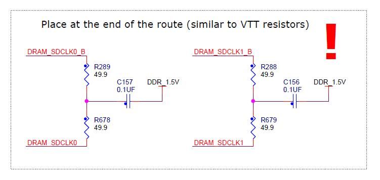

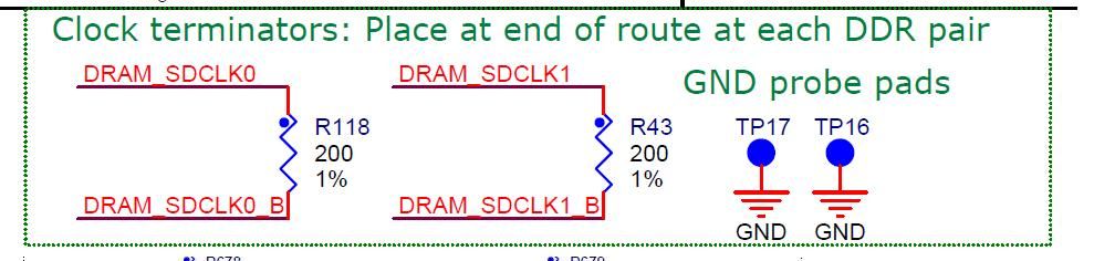

Hi  All
I found two different schematic on i.MX6 EVM,
On Validation cpu board
On Sabre_SD
Which one we should follow for DDR3 schematic design ?
Sincerely,Max

I think this App. Note may useful for you:
http://cache.freescale.com/files/32bit/doc/app_note/AN3940.pdf
