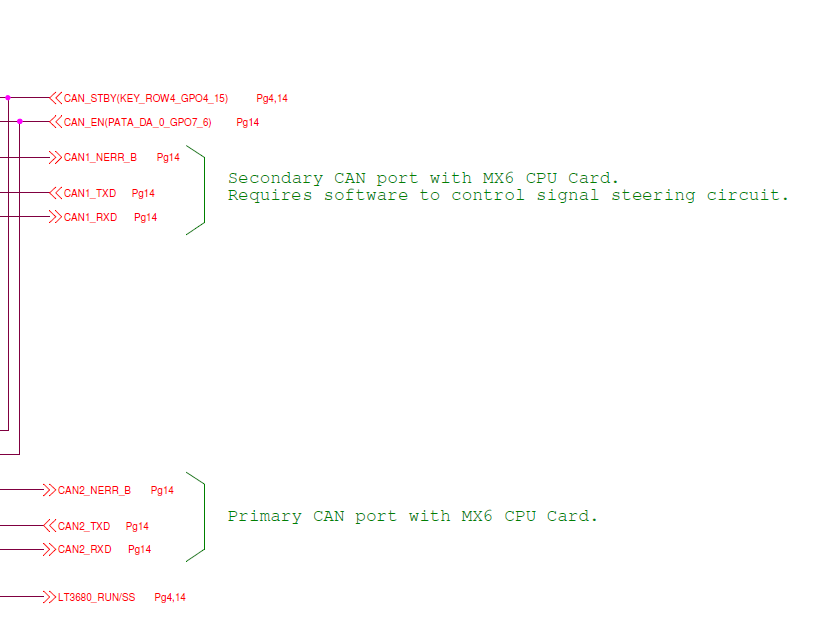

Hi All,
I have a question about Sabre B'd BASE Bd(Automotive) of CAN part.(I using I.MX6DL CPU Bd(Automotive))
Below That Schematics(Sabre Bd) ; CAN1 is secondary CAN port and CAN2 is Primary CAN Port
I wondering about CAN2 is default setting CAN PORTT Or CAN1 is default setting CAN PORT for Sabre BD with I.MX6 Sabre Bd of port.
658 Views
igorpadykov
Hi Inho
one can look at both CAN settings and testing at
linux-2.6-imx.git - Freescale i.MX Linux Tree
CAN interface in 3.10.9 kernel
igor
